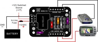

Have done some further thinking on how to provide power to new items such as GPS, USB connections for front/rear, battery tender and the likes. Don't want to get into a lot of wiring and relays. I'm a fan of not using the existing OEM wiring for this if at all possible. In this regard intend to install an accessory fuse block - the Fuzeblock FZ-1: . This is a very compact unit with an integral 30 amp relay, and combined power and ground bus - all in one unit. Have used the Eastern Beaver PC8, and inexpensive fuse blocks from Amazon powered through an external relay, but for this application, I think this is the way to go - should tuck in the "frunk" quite nicely. Another item I have been using for wiring is the expandable wire sleeve - comes in all sorts of colours and such, and does great job of making a nice, neat install
- had the bike apart to do an engine rebuild and complete paint job. I've attached two pictures of my '85 Honda GW Limited Edition wiring that I cleaned up - before and after picture. I use OEM style connectors instead of the solderless crimp connectors, and/or splice wires together and solder.
