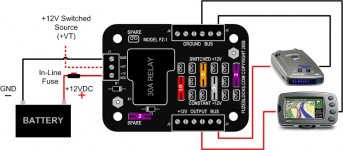

Will be installing a new accessory fuse block for my additions, keeping these separate. Have to find a trigger/switched wire for the activating relay. Thinking of using the Fuzeblock FZ1 because of its compact and integral design. Dimensions: L 3.25" x W 2.5" x H 1.25". Have used this on a couple of other occasions.
The FZ1 fuse block has an integrated power and ground bus, and the switching relay. This unit allows you to have switched or unswitched circuits depending on your requirement.
I've got a few days to make up my mind on this. There are less expensive ways to do this and each one has a compromise.

FZ-1 is great but keep it dry
I've used the FZ-1 in several motorcycle applications and it works great. I appreciate the ability to move a fuse from switched to unswitched when you change your circuit design. Two items of note:
1. With it's open design, you want to locate the FZ-1 where it won't be exposed to standing water.
2. The +12 and Gnd terminals (separated by the switched signal terminal) are fairly close together so if you are using #14 or larger wire make sure the wire insulation is fully seated against the terminal so no strands are exposed.
If you want a water-tight solution which can also accept relays (resistor-quenched of course) I suggest this one https://www.amazon.com/Concours-Spec.../dp/B01FWILO0Y
