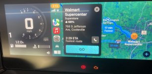

I just did some testing on my 2024 RT Sea to Sky, to which I had previously downloaded the Apple Carplay update.
I took my iPhone and helmet out to my Spyder.
I have Sena 3S Plus Boom Microphone kit installed in my helmet.
I turned the key to on, but did not start the engine at anytime during the tests.
First test:
iPhone not connected to the USB port in the glove box
Sena headset powered off
Results: Apple CarPlay icon shows up on the display, but it's grayed out.
Message on display when I touch the grayed out CarPlay icon: No phone connected via USB.
Second test:
iPhone connected to the USB port in the glove box
Results: Apple CarPlay icon shows up on the display, but it's still grayed out.
Third test:
Power on the Sena headset (which I had previously paired via Bluetooth to my Spyder)
After a moment (10-15 seconds) the Apple CarPlay icon activates, and displays icons of some of the Apps on my iPhone:
Fourth test:
Ask the CarPlay app to navigate to an address stored on my iPhone, my local Walmart
Results: the map changes to show several paths from my home to the Walmart with a box showing the address of the Walmart, that it has a 68% "like" rating, and the ETA for my arrival using the fastest route, along with a large "GO" button.
