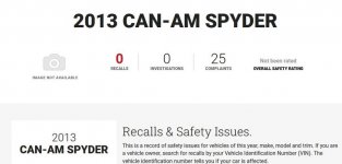

Weird, not seeing a recall on my 2013 ST-L
When was your Spyder manufactured? If it doesn't show up on a VIN search NOW, that'll probably be because yours has already had the recall done & recorded, possibly even before it was sold like my 2013 RT, so it's no longer an outstanding recall.... :thumbup:
