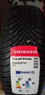

Thanks! Ordered 175/55R-15 Vredestein Quatrac SL
