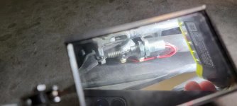

Curiosity got the better of me and I decided to disassemble the switch. I found the failure and got some new insight into the design of the wiring system. Turns out the switch simply opens or closes the red wires on one side, and the black wires on the other. When the brake pedal is released both are open due to the loss of contact on one of the slider pads. My switch failed due to arcing on one of the black contact pads as can be seen in the photos. This leads me to believe that the new superseded part was probably modified to add a stronger internal spring to the sliders' contacts. These ones feel pretty weak to me. The wiring diagram does not show these wires as two reds and two blacks; it just shows how they connect to the system harness at the connector. Black is ground for the lights. The red simply sends a discrete closed signal to the ECM to say that you've pressed the brake pedal. Brake pressure must be picked off from the VSS Antiskid module. These contacts are simply open or closed as depicted in the wiring diagram; no pressure signal is possible at this switch.

Jetfixer -- thanks for those pictures. Switch construction as I expected. The Black (brake light power) wiper damage explains your observations:
My switch failed in a bizarre way. If I pushed lightly on the brake pedal, the brake lights would flash one time extremely fast. Think like an old flash bulb. If I continued pressing harder, the brake lights would come on and stay on while held. If I pressed even harder, they would go off and stay off. Confirmed using a sensitive ohm meter after getting to the connector.

Picture 6 burnt black contact is bugging me. That degradation shouldn't happen with wiping action contacts, especially double-break/double-make contacts powering a small number of LED brake lights.
Except...
If you examine the beginning of the contacts, they aren't even. That means the wiping action is NOT DB/DM but rather single-break/single-make which is much more stressful current-wise.

I believe the following deficiencies led to Jetfixer's switch failure:
1. Use of slow-make/slow-break contacts for DC currents. [Design selection]
2. Uneven fixed wiper start points forces initial load current onto single wiper. [Manufacturing process]
3. Insufficient sliding wiper pressure and fixed wiper width for initial load current. [Design selection]
The BRP switch can be used for this application but needs some improvements to increase its lifetime.

I do believe that insufficient wiper pressure was the cause of this, and I hope that those springs were upgraded in the superseded switch. The springs in the sliding wiper are very soft.
In case anyone needs one, Brake Light Switch part # 710005480 has been superseded by Part # 710008326.

I just replaced the switch on my 2020 RT with the new version. I was getting intermittent VSS faults and Limp Mode. I determined the cause based on slowly pressing the brake pedal and watching the brake lights. As the switch pin was pulled, the lights 1st lit. But as more pressure was applied and pin moved out more, the lights went out, then flickered on/off, then went on solid at full extent.
As a precaution, I removed the in-line brake light flashers previously installed. I'm guessing the added current fried the switch.

It's not the flashers, it's the original switch. I also have the flashers and they work just fine with the new switch.
Just replaced mine on 2021 June Build 9500 miles so right before the new switch version. Had zero issues went on long ride out of no where cruise control kicked off and wouldn't engage. Thought nothing of it really then parked the RT in the garage and noticed the tail lights were on. Remembered this thread reached under and worked the switch back and forth and lights went out. Did a quick test ride and problem returned, dealer had the switch in stock he was willing to do it under warranty but do to service timeframe being a week out he gave me the switch. Took about an hour to do, I didn't remove all the plastics you can reach behind the main one, only two zip ties behind that area.
