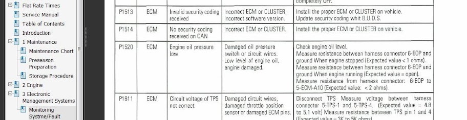

- Only been 1,700 since last oil change (yes odd to be that low on oil)
- It's throwing no fault codes
- I've tried all the little tricks to "reset" other than disconnect battery
- When I rev the engine to about 3900-4000 rpm's the engine acts like it's misfiring and will not go any higher on rpm's
