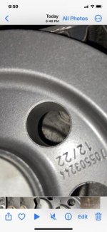

Askitee, I have a 17 RTL also, I had my front spocket recall done in May 2023.
Mine had the OEM black spocket that came with the Spyder it had a date of 2016 on it.
They put on a silver sprocket (dated 12/22) , I dont understand why you have been
through some many sprockets already. I have 30,000 miles on my Spyder now .
THE NEW REPLACEMENT SPROCKET IS SILVER

White sprocket (mfg 03/21) on my 2022 RTL (mfg 05/22)
