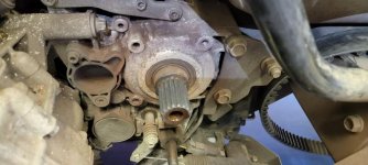

Info that might help when replacing front sprocket!

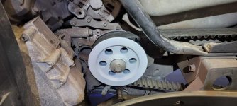

THE NEW REPLACEMENT SPROCKET IS SILVER
I have a copy of the Warranty Bulletin #2019-10 rev 1 September29,2022
Required parts, front sprocket kit, (includes washer)219800553 needed 1
listed as screw 250001017 needed 1
use loctite 609 or 603 torque to 111 lbf-ft +-4
No cure time listed.
CHECK THE NUMBERS ON YOUR DEALER PAPERWORK!
Way too much misinformation on this issue since the start of the problem,
We need everyone on the same page in the same book.
T.P.
