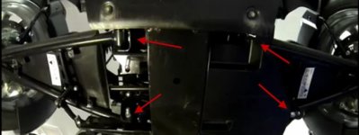

A Arm.jpgI have my services done by dealer, at the 9600 service I complained about the Squeak but of course they said they did not hear anything. Is this something I can do myself? or do you need special tools? I could not find a picture of the F3 A Arms but here is a ST. Is this the area you are talking about?

Zerk Fittings
View attachment 147775I have my services done by dealer, at the 9600 service I complained about the Squeak but of course they said they did not hear anything. Is this something I can do myself? or do you need special tools? I could not find a picture of the F3 A Arms but here is a ST. Is this the area you are talking about?
Yes, those are the sites for lubrication. Same as my 2013 STS.
Fittings are on the top of the arm - above the arrow.
I use an automotive grease gun and a 90 degree chuck.
http://www.ebay.com/itm/Powerbuilt-...pler-648815-/271726438014?hash=item3f4428667e
Its a tight/messy fit but it works.
Note - Grease fittings were deleted on some later model Spyders
Thanks very much. So how due your service or grease them now? Something that is dealer only, or do they not need greasing or servicing?
The ball joints are allegedly made of better quality and are permanently lubricated with higher quality, grease therefore they do not need periodic lubrication. The service schedule for post 2013 Spyders with the 1330 engine (don't know about the other models) calls for checking the ball joints and tie rod ends at the 9,300 routine service intervals. If you do your own service, each time you lift the front wheels off the ground you should check for play by grabbing the wheels at 6 and 12 o'clock and pulling them back and forth to see if there is any play in the ball joints and do the same thing at 3 and 9 o'clock to check the tie rod ends.
