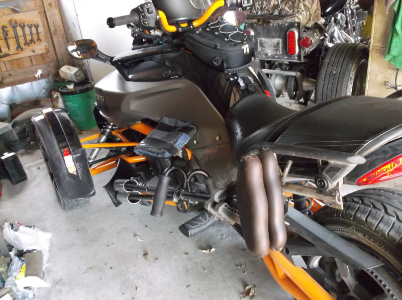

Koplin Clamps.....
1598539_10202631_is
Carry them the same way you carry rifle or shotgun on the off road 4 wheelers. Any sporting goods place should have what you need. I use the same clamps to carry my crutches on the Spyder.

An F3S has hand holds you can remove, and bolt anything on you wish. Racks, boxes, whatever. Take a look at the F3P model. It has adventure bike type luggage. That rack is available from Can Am, to convert the F3S to a F3P. Have fun. Make it work out for you. The bike itself is great. Make a rack, go shoot.
I left the hand holds on and made a piece that goes behind it. Got bungee strap loops, flag holder, and a mount for the clamp that holds the top of my crutches on it. The hand holds bolted back on over it.
