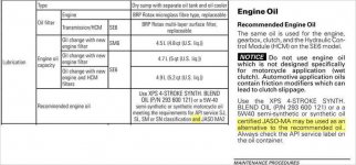

To clarify the confusion, take a look at what BRP Australia recommends in their manual. LOL Left box highlight and right box highlight BRp australie.jpg
The left side indicates SN and JASO, while the other side makes no mention of SN, nor does it mention JASO MA2; instead, it refers to JASO MA. The critical issue is not the distinction between MA2 and MA, but rather that three different pieces of information are presented within a two-square-inch area. ...
