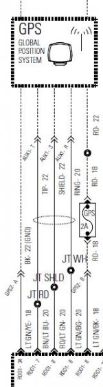

I have located the audio connector for the factor GPS and I see the two wire that supply power. Both of them are green but one has a black strip and one has a yellow strip. Which is positive?
It looks like the green wit a black strip is positive and yellow strip is negative.
