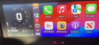

When everything is connected correctly you'll be able to see this on your display:

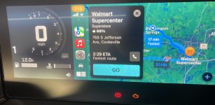

And this is what it looked like when I asked it to take me to my local WalMart:
