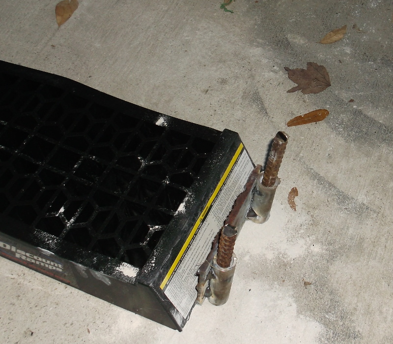

Not the most elegant solution, but ramps don't slide when they got a backing piece and rebar stuck in the floor behind them. When you pull the backing pieces out and throw them under the tool box, all that is left is a few 1/2 inch holes in the floor. Works for me, and it was free. All the pieces came from my scrap metal pile.
