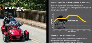

The Rotax 1330 ACE engine is running 12:1 compression (see pic below). Todays engine management systems incorporate knock sensors. When knock is detected (primarily due to lower octane fuel than specified) timing is automatically retarded to reduce knock. When no knock is detected, well you guessed it, timing is not retarded. The owners manual for us 1330 owners specifically states "premium" fuel for a very good reason. A compression ration of 12:1 is definitely in "premium" territory. Will is run on 87 octane, sure. Will is run more efficiently on premium, you bet. May not be something you can feel but your engine knows the difference.
Haven't investigated what the compression ratio is on the two Ryder engines but if their calling for "regular" fuel you can bet it's not 12:1 like the 1330.
