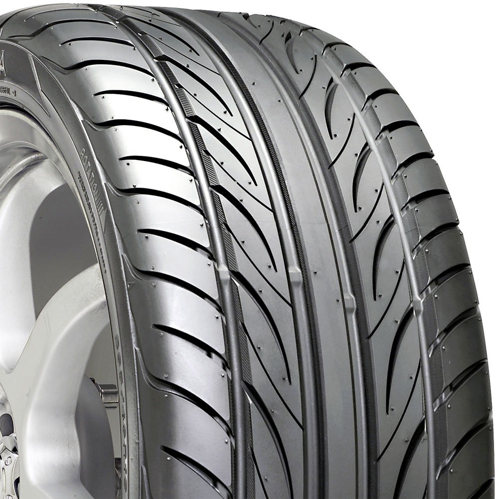

I just ordered this to try. It is a Maxxis Victra MAS-Z4S. It is available in our size.
Great looking tire...thanks for providing another option. Let us know what kind of mileage you're getting out of this tire....maybe one in the future for me...going with the Kumho Ecsta AST for now....
