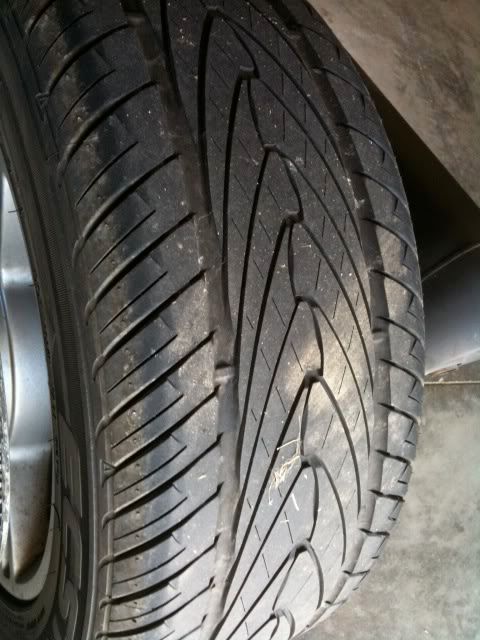

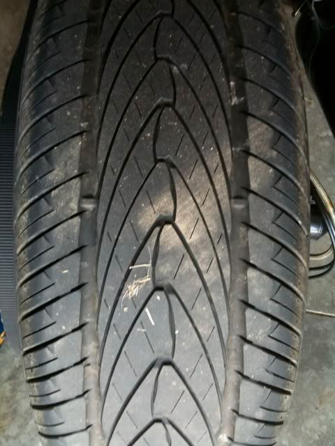

how is the tread after 10 grand
Both dltang and I have the same Kumho tire the lamonster has and we have not had any hydroplaning issues in close to 10,000 miles. On our way to meet you guys in Oklahoma, we went through a torrential downpour in Indiana (at 70 MPH on the expressway and 25 MPH on city streets) and the Kumhos worked fine.
Please tell me, how much tread left on that tire after 10 grand?
picture.php
I'll tell you and show you. :D Here are two pics I just took of the Kumho tire tread with about 11,000 miles on them now. I don't have a tread depth gauge but it looks like I have about ¹⁄₈" of rubber left before I hit the wear bar. I have ran this tire at 40 - 50 psi ever since I put it on.
