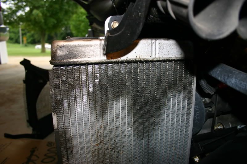

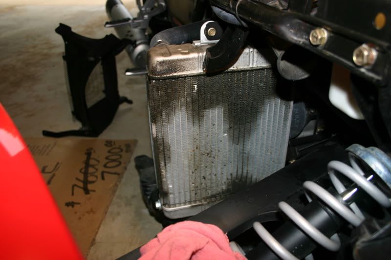

My Spyder seemed to be running a little hotter this year (it has been a hot summer) so I took a good look at my radiator to see if it was getting plugged up with bugs. Look at the mess I found. I am kind of embarrassed I didn't see this before now. Although in my defense it is hard to see things with all of the plastic on.
