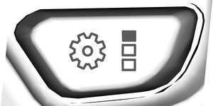

On the left handgrip, look for the Ride Settings Button.
It looks like this:
With the key on, Press it. This should open a selection window on the far right of the display.
Use the OK/Select button to move up or down to select Normal or ECO mode.
Press the Ride Settings Button again to select your choice, and close the selection window.

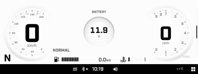

On my Spyder when I changed the setting it showed the word "NORMAL" or "ECO" above the fuel gauge.
Here's what "NORMAL" looks like, from Page 46 of the Operators Guide:
