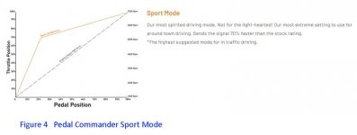

A small twist with Pedal Commander is translated into a large twist. That's all it does, and all it can do. This is interpreted by many as an increase in throttle response. If it makes you happy, cheers.

Pedal Commander makes several claims that are not factual.
"The Pedal Commander throttle response controller gives drivers full control of their gas pedal sensitivity."
In Normal mode and Eco mode, butterfly opening is limited by the ECM, so Pedal Commander cannot override this, and give "full control".
"For example, you can press the gas pedal all the way, but the ECM will open only 80%."
True, but only in Eco mode.
"Second, the program decides how fast the throttle body will open. In other words, it doesn’t really matter how fast you are flooring the gas pedal. The ECM controls the speed of the signal so your foot can not make the throttle body faster."
As my data shows, the Ryker ECM does not do this, but rather opens the butterfly as fast as is physically possible.
"By sending the information to the computer this way, a couple of checks that the engine computer will make can be bypassed before sending the signal to open the throttle plate."
This is plainly false, as the ECM is not altered in any way. I asked a Pedal Commander representative several times about how Pedal Commander does this, and got no answer.
"It gives you the response of an "old school" throttle cable, with a 1:1 pedal-to-throttle acceleration ratio."
In any throttle-by-wire system, there is going to be a very small delay as I have explained and shown. Pedal Commander cannot change that. Without Pedal Commander in Sport mode, you do have a 1:1 ratio between twist and butterfly opening. Pedal Commander actually changes the ratio between twist and butterfly opening, as their own charts illustrate. I haven't measured an "old school" throttle cable, but with that system you still must overcome inertia in the system, so I doubt that you could open the butterfly any faster.
If you want to add something that really makes a difference, get something that doesn't change the exponential of the throttle, spend a few bucks more and get the dang thing flashed.

"Because Pedal Commander does make the twist grip more sensitive, a small twist of the grip with it will open the butterfly more and thus deliver more power than the same small twist without it. This increase in sensitivity is perceived as improved throttle response."
It follows that by installing PC the throttle control inputs are going to move the butterfly wider (therefore increase the expected acceleration) than would otherwise be the case for the same rotational throttle input without PC. What isn't in question is the wider the butterfly opens the more fuel is available and the faster the engine will rev/ accelerate.
"Throttle response" in the context of this debate comes down to semantics. Clearly the throttle is more responsive....'twitchy as you put it. In fact PC is designed to make the throttle over respond to an input. It's clear this over responding is very noticeable by riders...your quarter turn is now a three quarter turn (for argument sake).
While you appear (to me) to have a solid argument on how the throttle system works the fact PC makes the bike accelerate further along the slew graph with less rotational input of the throttle is essentially the same thing as the ryker owners with PC are saying...the throttle responds better.....it's a rose by another name.....surely? :riding:

No, it’s not a rose by another name. It is throttle response (time) versus input sensitivity (effort or distance) and they are entirely different things, not different names for the same thing. And often confused.
First, addressing semantics, I have been careful and precise in my use of my terms. Others have not.
Some use the term “throttle” to mean the twist grip, and some use “throttle” to mean the butterfly. I have used the terms “twist grip” and “butterfly” to avoid any confusion regarding the meaning of terms.
Misusage of the term “throttle response” has happened in this thread and elsewhere. At the outset I defined throttle response to mean a measure of how quickly a vehicle's engine can increase its power output in response to a driver's request for acceleration. This is the generally accepted definition (https://en.wikipedia.org/wiki/Throttle_response), and in fact is the definition used by Pedal Commander on their website:
“…throttle response is more appropriately referred to as the time speed of increase in levels of power…”​
Note that nowhere in the definition of “throttle response” is there any reference to the amount of effort or the distance required to move an input device to increase power. That is sensitivity.
So when I refer to “throttle response” I'm referring to the time to increase power.
Since the data shows that in stock condition the butterfly can be opened as fast as the throttle body slew rate allows, maximum throttle response (shortest time to increase in power) can be had in stock condition. Pedal Commander does not and can not improve throttle response; to do so would require the butterfly to move faster than it is physically able.
Pedal Commander alters input device (twist grip or pedal) sensitivity. Again, from Pedal Commander’s website:
“It lets you adjust how sensitive your gas pedal is.”​
So yes, if you twist the grip less than 100%, the more sensitive input device is going to cause the butterfly to open more. But this relationship is independent of time, and therefore is not throttle response, it is sensitivity. I have acknowledged that an increase in sensitivity is (wrongly) interpreted by many as improved throttle response.
I have consistently and clearly stated that Power Commander alters sensitivity but does not alter throttle response. I have postulated and then proved with real word Ryker data that if you twist fast, you get the maximum possible throttle response out of a Ryker.
