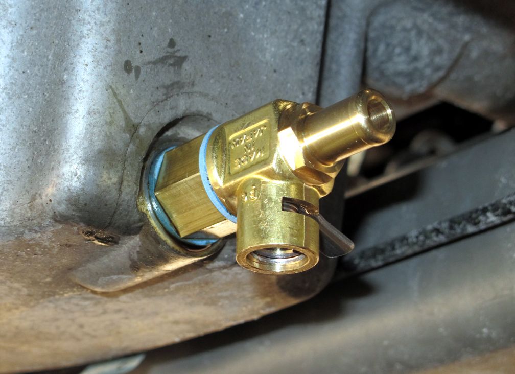

Any reason not to use a fumoto valve in there?
http://www.fumotousa.com/
I have one in my Mercedes and had one in my Saturn Sky Redline.

I've used Fumoto valves on my cars as well. General consensus here was that there isn't enough clearance under the bike for the valve. Although they do have a low clearance version that could work.

On the subject of the drains mentioned above----- if they arn't too long they would fit just OK. I've bottomed out at low speed (off road ). Glad there was a heavy duty bumpskid there. I'll stick with the hex replacements I put in last oil change:)

What if.....
....we would use a 90 degree to install the valve horizontally....?
