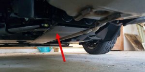

If you plan on changing your own oil it sure makes it a lot easyer if you can get it up on stands to work on. Here's a few pics as to where to place the jack and the stands.
I use a 1500 lb motorcycle jack and it lifted the RT no problem.
Back pad is almost directly under the driver foot peg.
picture.php
This is where it hits on the frame.
]http://www.spyderlovers.com/forums/picture.php?albumid=494&pictureid=6366[/IMG]
Place jackstands under a-arms
picture.php
picture.php
Place jackstand under rear shock.
picture.php
