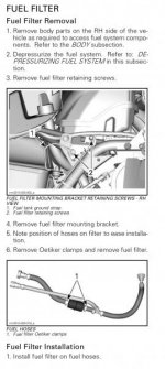

The following are from my 2015 RT manual. See if this helps you.
Rob
Screen Shot 2019-10-17 at 9.34.29 PM.jpg Screen Shot 2019-10-17 at 9.35.09 PM.jpg
