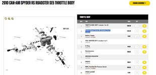

I suspect your fuel injectors may be stuck.
Try cranking a few times and pull the plugs.
If they're dry, the injectors may be stuck closed. If wet with gas, they may be stuck open and flooding the bike.
Once you do figure out the problem, if it was flooded, I'd change the oil before running it more than a couple minutes.
