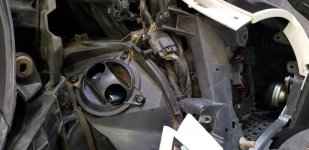

Those with the WickIt Stage II kit, what are they requiring to have done to the stock air box?
Mine has been totally removed and I have a round air filter over the throttle body.
(2) 1" holes drilled into the cover, like this:

I want to do the ECU stage 1, but I can not figure out how to release the ECU from the connections. I have looked at the pictures and they are not specific, like exactly push this tab here.. I have a 2015 RTSE, I got the 3 screws out but can not get the lock tab to release... can someone take a picture with a flash and show me the exact place to put pressure on ?

the locking black tabs are located at the bottom of the two connectors..you PUSH them in while turning the lever at the same time unlocking the lever.
They are the tiny black tabs in the middle of the cross bar on the cam-lock type fasteners. Once you see them, you really won't need a pic.... but if your 'close vision' is becoming anything like that of most of us as we age, you might need longer arms, or a magnifying glass!! :gaah:
The tabs are quite small & insignificant looking, but they're right in the centre of the cross bar, and they REALLY WORK at stopping those fasteners from ever coming undone accidentally!! :shocked:
Good Luck! :thumbup:
I can't remember where a picture was just posted a few days ago. The releasing mechanism folks are talking are small oval shaped button type thingys. One under each locking tab or get a small mirror and look there. I feel your frustration, I looked over and over again and there they were right under the locking tabs. As I said earlier, they are very small and sort of oval shaped. You must push them in and the release tabs will move easily so you can pull the connectors away from the ECU.
thank ya'll so much, I will look again.
With me I had to pull the ECU out as much as I could so I could turn it to be able to look at the end close up. the tab is in the end area and once you have it pushed in the lever will almost pop over buy itself. Once you figure out the first one, the second one is right behind it.

Ok, after turning the ECU upside down with the connection now on top and with a mirror, I found this mysterious oval shaped "button", kinda small, but I pushed it in and low and behold it was able to release the hold it had on the lock.....and took the advice and removed the filter top cover and sent in both items to wick-it in Shreveport. Thanks Ya'll
