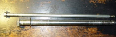

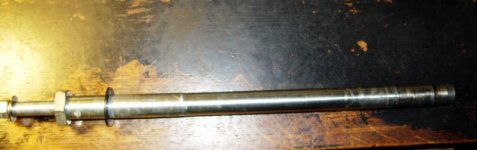

Look on the right side with a mirror and see where the end of the hitch bolt is. Attached are two pictures. What I think is going on is you got the right side of the bolt out of the hitch and the left side might have moved which is locking it in place. I would keep the rear wheel off the ground. At this point in time all you are trying to do is get the hitch bolt out. This bolt just slides thru axle. Wiggle the hitch left to right while pulling and turning the bolt with a pair of vise grips and see if it comes out. The pictures are for a reference as to where the bolt is in the axle. Notice the left end and right end of the hitch bolt. These two areas are the only place the hitch bolt comes in contact with the inside of the axle bolt.
I'm sorry, I did not look at your pics close enough. You are not having trouble with the axle, it is the hitch bolt. Did you remove the cotter key before your removed the nut? If not, you will shear off the cotter key and the nub that is left will prevent the bolt from coming out. Drive the bolt back ibn and check to see that the key hole is clear and that there is no remainder of ther cotter key on the threads. After that push/turn the bolt out, wiggling the hitch side to side as you do, as Doc said. The bolt should remove readily if you get things lined up. Same for the axle bolt, afterwards.
I'm sorry, I did not look at your pics close enough. You are not having trouble with the axle, it is the hitch bolt. Did you remove the cotter key before your removed the nut? If not, you will shear off ther cotter key and the nub that is left will prevent the bolt from coming out. Drive the bolt back ibn and check to see that the key hole is clear and that there is no remainder of ther cotter key on the threads. After that push/turn the bolt out, wiggling the hitch side to side as you do, as Doc said. The bolt should remove readily if you get things lined up. Same for the axle bolt, afterwards.
My hitch was a 5 minute removal maybe 10 at the most including getting the tools out. NancysToys' gotta be on to something here, that thing should just slide right out then a good side to side wiggle on the Hitch and it should just slide off. Sorry for your problems, hope Teddy gets relief soon.

Dave, the 'axle bolt' is a hollow tube the hitch bolt slides through. I believe the axle bolt may be part #17 in your diagram. When I first installed the hitch, my assumption was that I'd have to remove the existing axle bolt and replace it with the hitch bolt. I was wrong. The hitch bolt slide through the hollow axle bolt.
