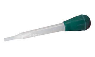

Try a baster with a length of hose clamped to the end, when it sucks air, you can get an idea of the level you're working with.
