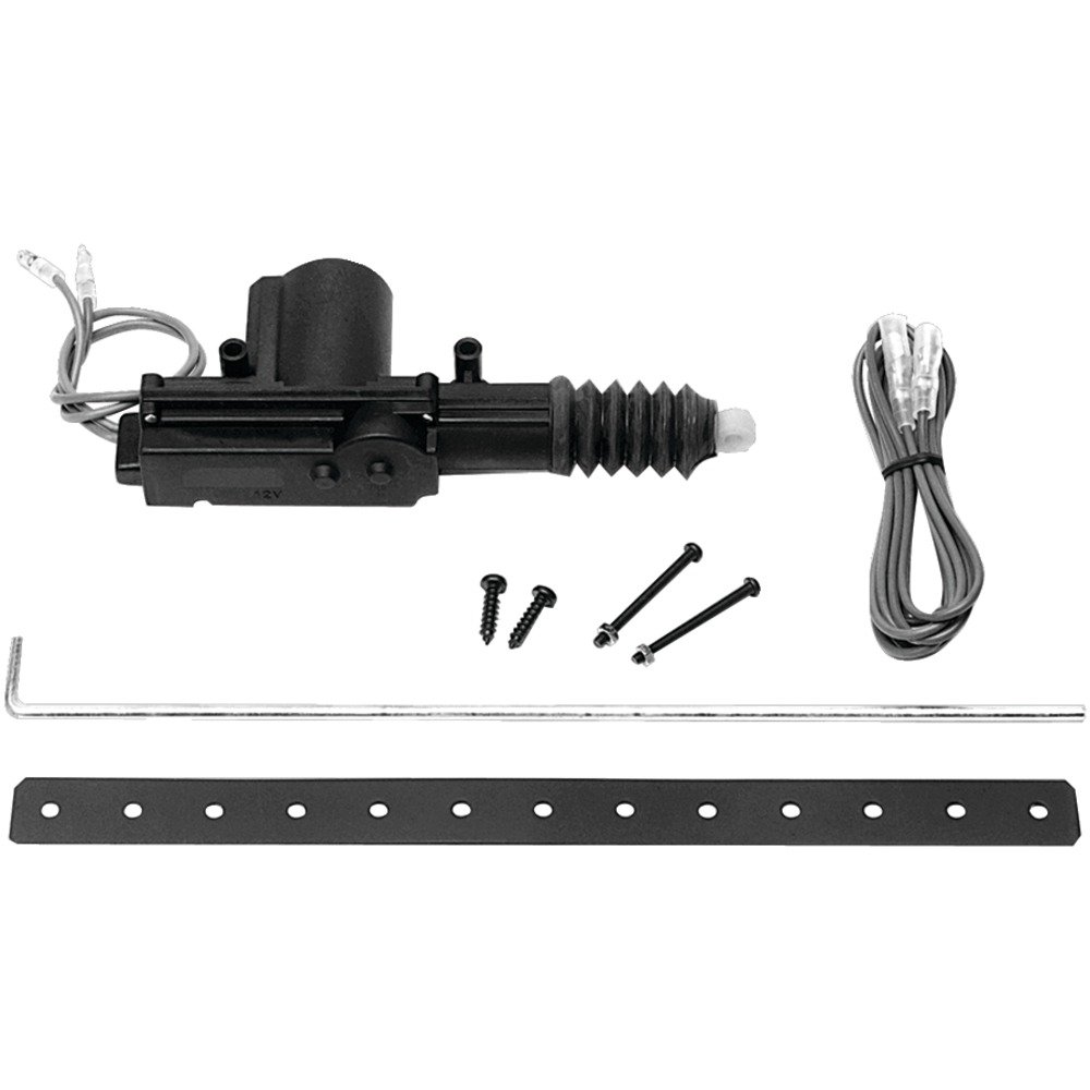

Here is a pic of the power door lock actuator I bought open my frunk on the 14 RTSE6. This and the switch cost me $12 from Amazon. The actuator mounting matches the look and the bolt pattern of the stock set up. No complicated wiring is required since it only needs to be powered to operate in one direction. It is gear driven so ample power to push the release arm to pop the trunk. I plan to install the momentary contact switch to operate it in a discrete location and have it powered all the time for convenience. If I were worried about security it could be wired to a ignition circuit wire so it would only open when the bike is running.

Here is the amazon location for the kit:
Install Essentials 524T 2 Wire Standard Door Lock Actuator Kit
Sold by Amazon.com LLC
That sure looks like a knock off of the OEM unit, which I bought for $55. Wish I would have known this one existed. If you haven't already I suggest you go ahead and buy the OEM bracket for about $7. It simplifies the installation greatly.
I take it the '14 LTD doesn't come with an actuator. If you can find a part number for the hood opener switch that used to be, or maybe still is, available a simple wiring change under the center switch group will allow the switch to be added there. Or are all four switch positions being used? Another option, for like about $55 is to buy the combo parking brake/hood switch and plug it right in. The business end of the harness for the actuator should be right under the lights near the hood latch.

I'm always afraid I will break the key off in the ignition and this sounds like a good idea whether its switched or always on demand. Does one then disconnect the cable that runs to the ignition switch? will the actuator arm return automatically once the trunk latch has opened/, where can I find a waterproof ON momentary OFF switch? I am sure I can eventually figure it all out, but I'd rather not invent the wheel if some good samaritan will share the specifics.
No.
Yes. It releases the latch and then returns to home position. It's really not an arm. It's a plunger.
NAPA has one, but it's big. Your best bet is to just search Google or Amazon and look for a weatherproof push button switch. I bought a weatherproof toggle from some online marine supplier.

got these from DEl City, it is an OFF momentary ON switch and they can be fitted with a waterproof rubber cover.
7100011 SPST (ON)-OFF Push Button Switch, Round, $3.40 $3.40
1 7900002 Black Push Button Boot (1 MIN) $2.89 $2.89
I plan on mounting them somewhere on the left side on the tupperware and switched to the ignition so they will essentially be locked except when the key is turned ON
