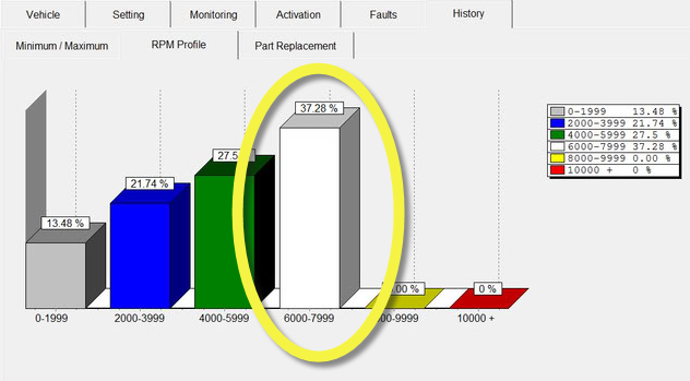

My RPG range has now changed for the 3rd time since picking up the RT. I've tried to always shift between 5500-6000 RPM. the first step change happened after my 600 mile service. Where I had been around 5300 in 4th running 55mph, I was now at 4800 in 4th at 55mph. Well now, after reaching 3000 miles, I'm running 55mph in 3rd gear at 5000rpm.
Has anyone else expierenced this...or should I be concerned?

so what would be the correct/effiecient ryding mode:
* maintain 5500 rpm whn 55 (3rd gear)
or
* 4th gear at 55mph (lower rpm)
or
There is no correct answer. It depends on your riding habits, and the terrain, as well as traffic and any need to accelerate more quickly. It will cruise at 55 at about 4,500 rpm in fourth nicely, or even in fifth, but that's a stretch. I usually use fourth on a flat rural highway. If there is a lot of traffic or towns with reduced speed limits, steep hills, or my Spyder isn't running well, I drop to 3rd. Do whatever fits your needs and feels right to you. If it runs rough or seems to miss upon acceleration, go down a gear.
