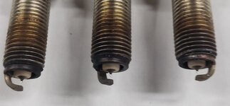

So, why this post? Let's start by looking at the unaltered plugs we pulled.
A little rich, maybe. But the cold start cycle will always be rich. Which is what these plugs would show, not running well enough to go more than a few minutes. Bottom line is they look to be in very good condition.

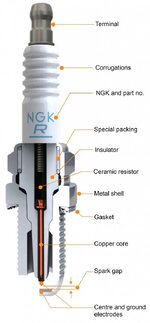

But, as shown in this anatomy of a Spark Plug picture, there are critical internal components which deteriorate with use. Again, well made and able to withstand long term use better than older designs, but without the ability to visually inspect. This deterioration can be slow and the customer may not notice the degradation in performance.
Granted, this Side-by-Side is on the Dire Case end of the spectrum. Frankly, both Daniel and I were surprised that spark plugs alone cured the problem. Especially after visual inspection.
