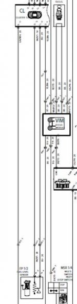

My 2014 RSS manual shows that the sending unit is not grounded. There are two signal wires that run straight to the cluster. I believe the cluster is grounded through the wiring harness at #4 in the drawing.
PDF shop manuals are relatively inexpensive. I wouldn't work on a Spyder without one.

Once you do, you'll see that the cluster runs everything regarding those gauges. There is no separate gauge ground.
