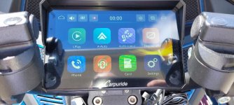

I went with the 5" display thinking that the 7" would be wee bit larger than needed. The 5" fits well on the ball mount right center in front and powered through the center usb connection.
just came back from my first test run with the Carpuride ACP. the ball mount attached to existing mount on bike and plugged into the bike's usb connection. BT my phone to the device. I BT the device to bike as a helmet audio. Used the map app to a fueling station and audio came through bike speakers. I was listening to XM while exercising this am up town on ear buds. when came out turned off earbuds and started bike which then sent audio through bike speakers. the ACP is better than my Garmin which I have used for years. Paid $181.00 direct from factory. feel this is a good setup. Yes easy to use and readily easy to see during daylight. Time will tell if it is better than before.

Update on my Carpuride. It has the 7" screen, and it does not fit between the bars. I thought for sure it did, but nope. I still like where it is, though.
I have the 5" Carpuride ACP unit assembled and working. It is attached to the handlebars on the right side of the center attachment with a ball mount and hardwired to the frunk accessory harness. My iPhone is paired to both the bike and the device. For Google Maps, the device runs through a Bluetooth interconnect that is plugged into the connections in the front dash compartment to deliver instructions through the speakers of the bike. If I want to listen to XM radio through my iPhone, I set the audio output of the bike to BT radio and the sound comes through the bike's speakers. ACP has now replaced my Garmin. This may not be the best connections, but it works for me.

I have the Carpuride W702 on my 2022 RTL Bluetooth connected to a dongle that is plugged into the USB connection in the glove box, and then I have my phone Bluetooth connected to the Carpuride. Everything is working great, I have to select the Aux setting to hear my music on the bikes speakers which is not a problem.

I have the Carpuride W702 installed on a 2023 Spyder RT, so far, I am loving it. I did use the BRP app for about a month, but I prefer to use Waze or Google Maps, hence the purchase. To install it, I ordered the Bar Clamp with 1” ball from Lamonster Garage (link below for visual reference). And I am powering it via the USB port in the “glove box” which I have had no issues with. But I also do not have any other accessories or power draws on the electrical system, so your mileage may vary on this.
My setup has my iPhone connected to the Carpuride unit as well as my Cardo unit on the helmet. I can control maps, and music from the Carpuride screen. Because it is Apple Car Play, only certain applications will show up on the Carpuride screen (you probably know this but throwing it out there just in case). Also, I have not tried adding the handlebar controls into the mix yet, so I’m not sure if that will work. I have seen a post on Facebook where someone said they were able to.
