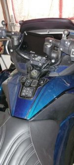

I'm going to take pics of the mods I did over the weekend. I installed the 7" Carupride, and with the ball mount, it fits good, and it doesn't interfere with my speedometer cluster.
Here's the pic of the Carpirude. Pardon the dirty bike. I had to replace the battery yesterday and haven't had a chance to wash her yet.

My Zumo XT2 was a close fit between the Helibars. Looks like your 7" Carpirude has to ride behind the bars.
It does fit between the bars, barely, but I didn't want it interfering with my key. It sat right over it. Also, with it being between the bars, it was a distraction when looking at my gauge cluster.
OK - The picture is a bit misleading as I have direct sight line to the gauge cluster with the XT2 up/between the bars. But, I am also 6'3" and sit quite high in the RT seat :)
I'm 5' 10" (yes that is average so stop laughing). I can see the cluster gauges, but the unit is distracting to me if I put it between the bars due to the ball mount and ball mount coupler I'm using. Might also be a little OCD thrown in there as well. When it stops raining, I'll try and get a better picture while sitting on the seat.
