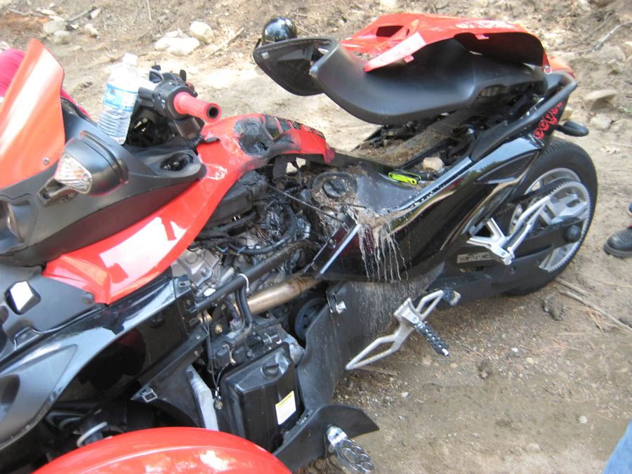

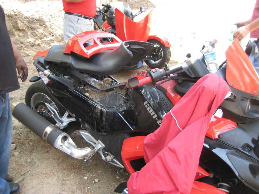

He rode with me 581 miles on sat with no issues and followed me up for this ride on Sunday as well, he is a regular Ryder on the West Coast Spyder events.
The bike was an SE5 and had been in the shop 3 times for what he said was a gas leak; dealer could not find the issue.
The bike did have around 15K on it
He was on it when the flames came through the tank area - the fire came up the left side but appeared to start under the tank some place but not necessarily on the left side.
Please do not read into it more than the accurate info that I have given, at this time the cause is unknown. It is sitting at the dealer and is being looked at.
The ryder was not hurt and the damage was far less than the other pics that I have seen but I would guess a total.
IF and when the cause is determined I will post only accurate info.
Additionally it is the owner of the bike that would give the best the most accurate info on what happened - If he wishes to.
It clearly is not my place to speculate.

I took my truck into the local mountains with my wife (BlackWidow) and our dog.
We saw a few Spyders pulled off to the side looking like they were resting. Well it seems Ken5517/Wish Again was broke down waiting for a trailer, he had an electrical problem.
We also found out that another Spyder in the group caught on fire and was stranded down the road. We left Ken and others (who names I already forgot:dontknow:) with some water and continued down the road to see if we could lend a hand.
We found them a 1/2 mile further. Sure enough there was a red spyder that caught on fire. My wife know his name. It seemed to have caught left side in front of the gas tank. The fire started while he was making a uturn. Fortunately there was a convenient spot for him to pull out and to try and dowse the flames. I took pictures but I have them at home and I will post them later.
We left him with a Sprite and went. A couple of hours we returned by the area and they were are gone. So I hope that at least everyone got home safe.
This is the first I heard of them catching fire while riding. I wonder if altitude had was a factor. It happend at about the 7000 ft level.
