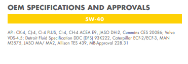

    I snipped this from the Shell website regarding Rotella T6 Click on it, it'll enlarge it Capture.PNG

    See post above, then check your owners manual for applicable API ratings.

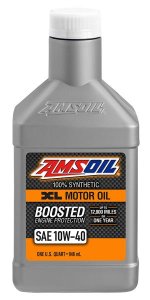

    I am not recommending anything yet because I have not personally run it or tested it. But frankly, I cannot see where it's going to be a big deal to run engine oil in an engine. I like Amsoil because it does what it says it does and I've yet to see an oil test out, apples to apples, better than Amsoil. So I've decided to go with Amsoil's XL, 10w-40 which I feel is a better viscosity fit for the Spyder/Ryker anyway. Amsoil also has an even higher quality lubricant, 0w-40, which is tempting. I may try that and see how it fares against the 10w-40 on the next go-around. I am certain that either one will far exceed any requirements that BRP has.
    It will run about $8.75 per quart. Who knows! I might even be able to get better fuel mileage with it!
    I know some feel Amsoil is overkill for the Spyder/Ryker. And I can't necessarily argue with that. It's all a matter of perspective. I plan to switch out to all Amsoil lubricants eventually.
    Here is some of the description for the XL oil.
    AMSOIL XL Synthetic Motor Oil is the choice for those who want to do something extra for their vehicle. Its boosted formulation delivers extra cleaning power, outstanding wear control, excellent high- and low-temperature protection and exceptional fuel economy. XL is engineered for advanced automotive technology, including turbos and direct injection. It is packed with extra engine protection, allowing you to go up to12,000-miles or one year, whichever comes first, between oil changes. XL Synthetic Motor Oil maintains its fluidity (viscosity) under the most extreme conditions. Some oils break down and significantly increase in viscosity after extended periods of high-temperature operation. These changes can cause excessive oil consumption, engine deposits, accelerated wear and difficult cold-starts. The GM Oxidation and Deposit (GMOD) Test consists of a 5.7L V8 engine running at 293ºF (100º hotter than normal) for 100 hours. These severe operating conditions test an oils ability to control viscosity increase, deposits and oil consumption. The testing revealed that AMSOIL XL Synthetic Motor Oil provides 64 percent more protection against oil breakdown than required by the GM dexos1® Gen 2 specification, ensuring protection in extreme temperatures.

    BRP rescinded that requirement and now requires JASO MA2 for wet clutch. BRPs own XPS oil now has an SN rating.
