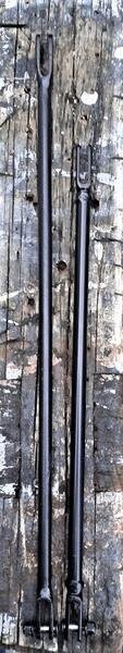

I toyed between position 3 and 4. Made a separate rod.
In the end I settled for the bought online adjustable one.
That way I can adjust the brake pedal to where I want it.
Also I can shorten it up for when the Wife wants to ride it.
bar 1 2 20220524_084110.jpg bar 2 1 20220524_084136.jpg brake rod s-l1600.jpg

My 2nd photo shows the difference between the stock 3 and my longer home made position 4.

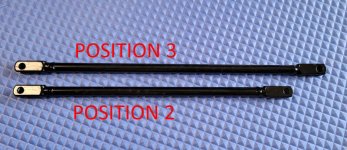

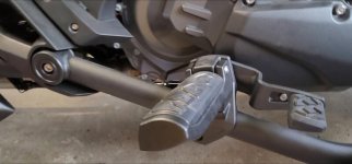

Keep in mind that if you are currently using a #3 rod, then Lamonster's #3 rod will lower the pedal substantially. His rods are made to lower the brake pedal using the same floorboard position.
I learned this the hard way. Can-Am's "Ufit" is not as flexible as they make it seem. If your pegs are comfortable at position 3 then using any rod other than the position 3 one will not work. Pedal height is NOT adjustable and is fixed at the 45-60 degree angle with their parts.
I ride at position 3. I bought a position 2 rod to try and lower my pedal. Well it sure did. :yikes: The pedal was so low it was not usable.
The images attached show the size of the two rods and the position the shorter rod puts the pedal in.
Time to buy the adjustable one...
