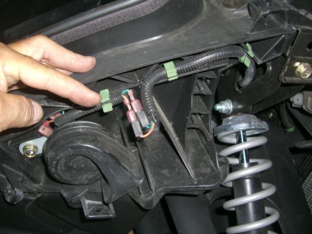

This might seem a stupid question, but could someone please tell me, where the heck is the horn situated. I spent the best part of an hour today looking for the horn and the switched power plug. Eventually found the power (cable tied inside the upper suspension bracket). Getting to release it was another problem. Still couldn't find the horn. I'm hoping to fit my Stebel air horn and an axillary fuse box.

Standing in front of the :spyder2: remove the right front panel that holds the fog light if you have or the vent panel .Just above the right front wheel and mid way between the top and bottom of the trunk you will find the treasure you seek.Also on opposite side a little closer to the front is the outside temp. sensor.
Please let me know how your Stebel horn install goes as i would like to do the same to BRPs sick sounding horn as i hear some of the Stebel horns draw a lot of juice and cause trouble with the nanny

Do I have a crooked eye or is the horn pointed backwards?
I guess it works well notifying traffic behind you while you're backing up!:joke:
Thanks everyone, now I know. I did try the press button and listen method, but all that told me was that it was on the left. Glad you guys (and girls) are around. Saves a lot of frustration.
