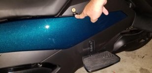

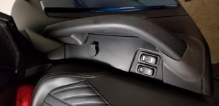

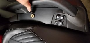

I mounted mine lower on the left and the passenger one next to the heat switches. Both are run directly to the battery, which has the added benefit of being able to plug my battery maintainer into either one.
:dontknow: I think my wife could break that plug off in short time, getting on or off the bike!!
That's very well done. Are SAE receptacles easily sourced?
Yes. A quick search will find them. I can't remember exactly where I got these from. They have a standard SAE disconnect plug on the other end of the cable (about 6-8 inches long). This allows me to unplug the passenger one whenever I need to remove the side panel by the grip.

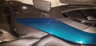

Well, it took me longer than it should have. Twin 3-year-old grandsons were here for the weekend and needed my attention, and I was happy to give it.
Here are the end results
Thanks so much for all the input from everyone.
A shout out to Bajaron for steering me in the right direction with new wiring leads!

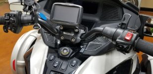

I brought my power up and zip tied it to my handlebar. Look closely and you can see it peeking out on the left side. I also use it for my battery tender.
