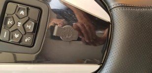

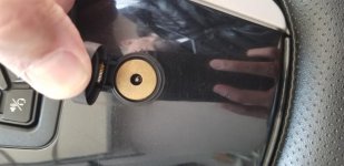

I have a direct line (with an inline fuse) to my battery for my heated gear. I also use it for my battery tender.
