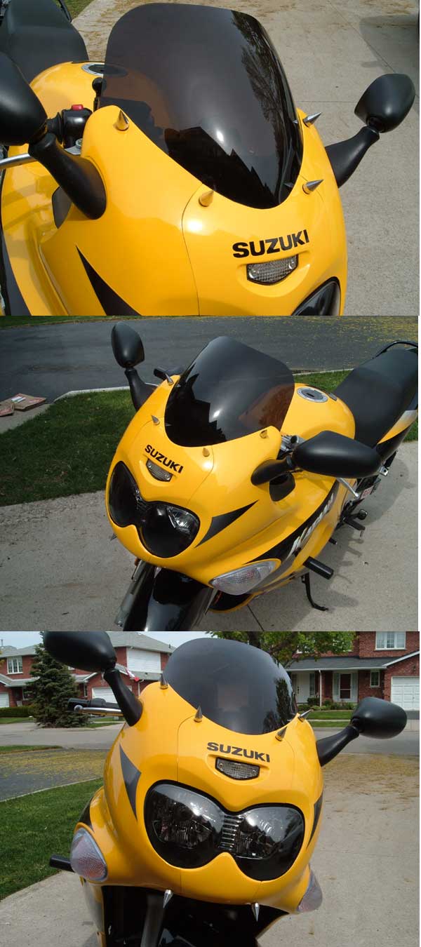

What do you guys think?
I will agree that pointy screw heads would be the least of your worries in an accident, but after doing safety work for many decades, it had to cross my mind. In actuality, I would be more likely to gash my leg climbing onto the Spyder, or stab myself leaning against it absentmindedly while parked. LOL
If you really want to do this, you could try purchasing some of the wrong size bullets, cutting off the threaded part, then drilling and tapping the remainder for the correct screw. Saw off the head of some of the correct BRP or matching screws, and insert them. Don't forget the Loctite. Where there is a will there is a way.

na not for a spydrrrr, not the right look :thumbup:
Hey ghost i was at a bike show today i saw threaded bullets i think they where for the license plates so they are 1/4 inch threads would they work.
Not really sure but I'll find out as soon as I get back from work, maybe next week or the week after. My girlfriend's brother works in a machine shop so he might be able to wipe something up:pray: If that doesn't work, I just got an email from a site called SpinWurkz....they might be able to help me.....just need get home and measure the stock screws:)
