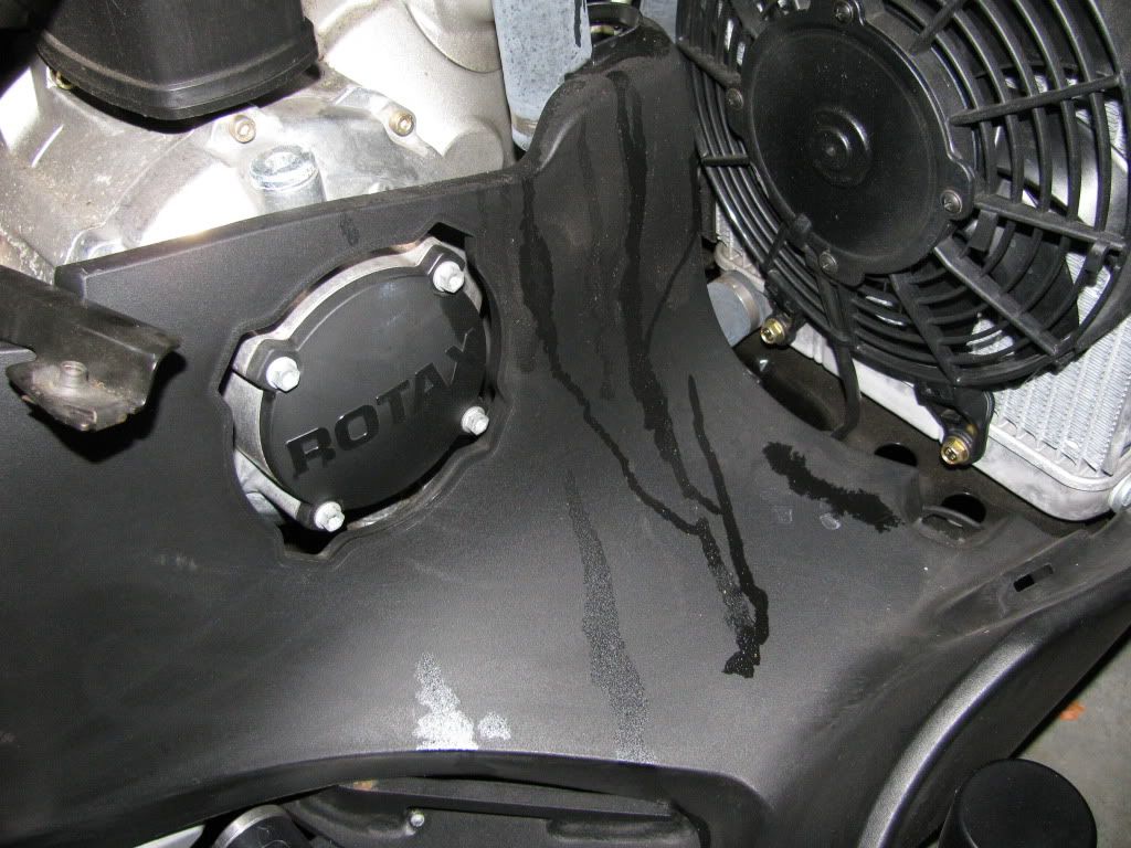

First off, this is what the leak looked like on the panel right behind the radiator.

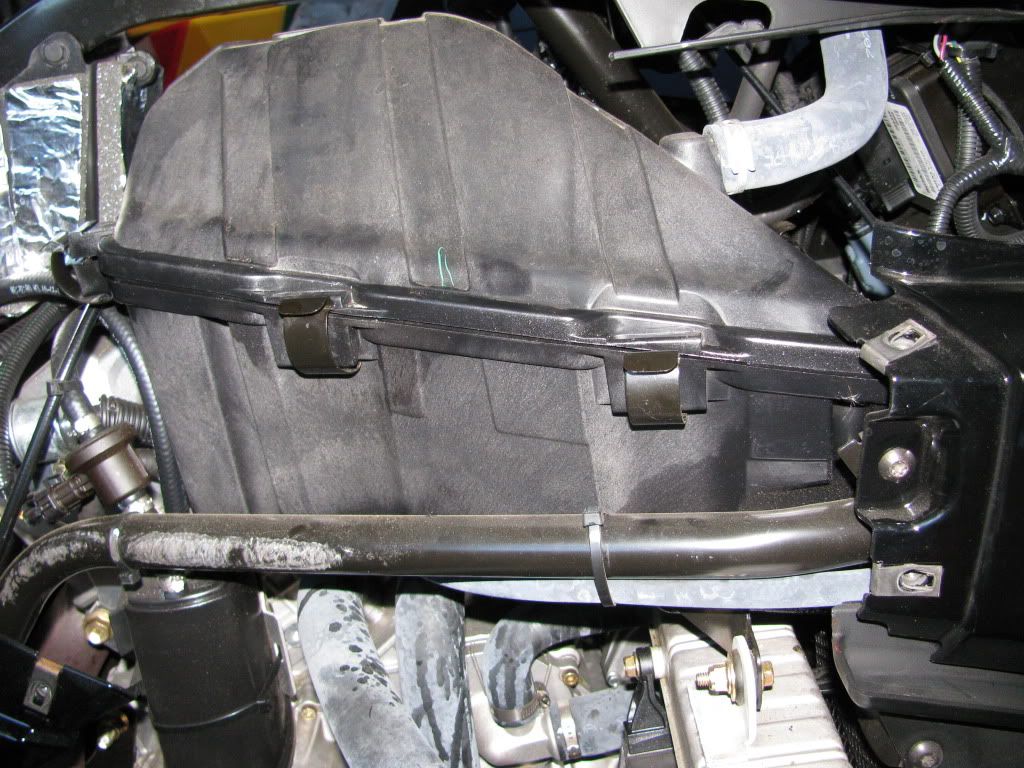

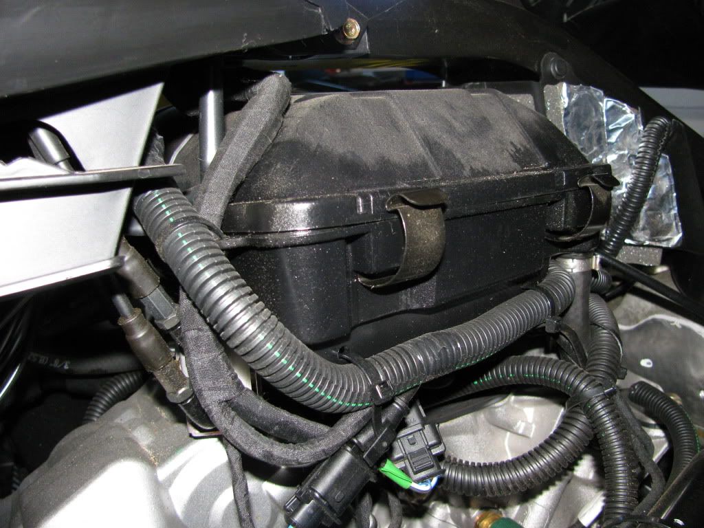

Here are a few shots of the oil that is all over the airbox.

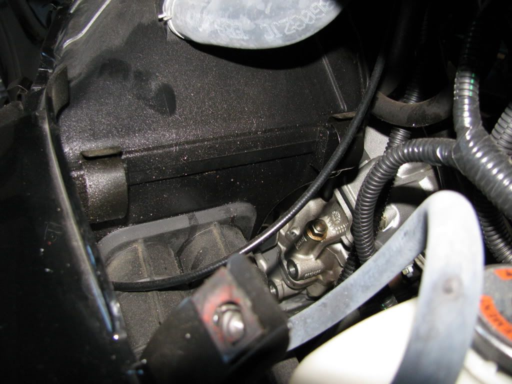

In this one you can see the oil drip marks all over the hoses under the airbox.

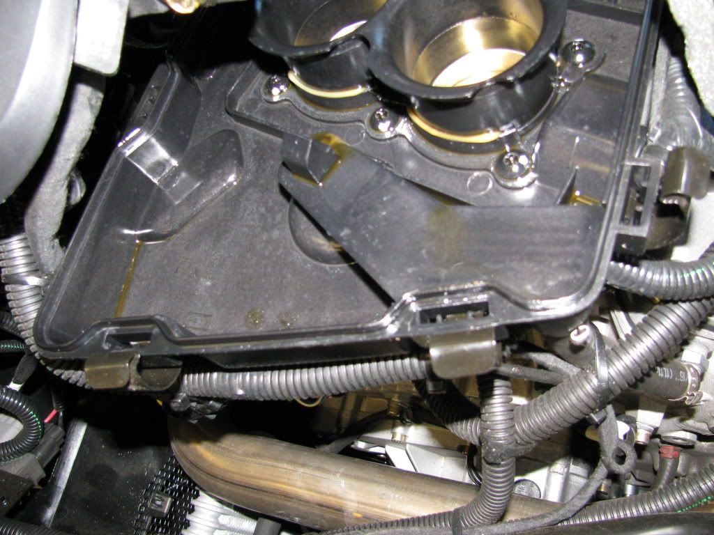

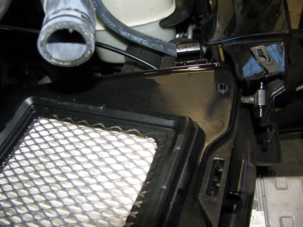

In these last two you can see what I found when I removed the top of the airbox. A FAT LOTTA OIL!
Surprisingly, the filter did not look like it had been fowled with oil. I will be replacing it all the same though. I am really amazed at what a mess oil in the airbox can generate all over the engine. I will also be checking the oil level tomorrow. After reading several posts here, I suspect the dealership may have overfilled at the last service. Any words of wisdom would be greatly appreciated.
Same deal here, 2008 SE5. At first I though that the dealer overfilled it, dropped the level, same thing. Tried several fixes, so far Lamonster catch can works the best, just remeber to plug the botttom hose to the airbox on the left. Do the search for Lamonstr oil catch can, ther's step by step instructions
You will probably have the oil in the airbox with the oil at the correct lever (or even somewhat low).
Modifying the crank vent system is the best way to fix this once and for all.
Looks like oil blow bye from the crankcase vent hose.
I fixed it on my 08 Sm5 a few years ago with a 1/2 inch piece of foam in the vent hose.
Did that to my Kaw.
I accidently overfilled my 05 Kaw Vulcan 2000 when I had it and that's exactly what happened to me. Messy!
