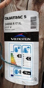

I'll post a picture of an actual tyre label so you can get a better idea how it is done. The label is attached to the tyre tread.
However, the final choice is yours. Good luck with it! :thumbup:
Edit: Green, Grade A is good, red is bad.
