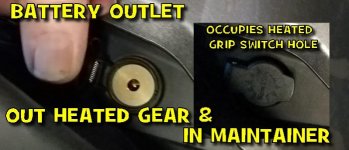

Pretty sure they are protected by a 7.5 amp fuse. Not robust enough for heated gear nor is the wiring. Wire your heated gear to your battery directly with an outlet from Warm n safe. It can also serve as inlet for a battery tender. My 2016 had an SAE pigtail connected to the battery under the frunk bucket. It had an inline fuse for 7.5 amps which I switched out for 15 amps. That wire is robust enough. If yours did not come with one, see the dealer that you bought it from and demand it gets installed free.
