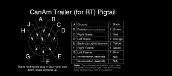

I do not recommend wiring directly. The BRP harness contains and integral converter module, and is powered off a separate circuit. There is no simple and cheap way to accomplish this, and the BRP module is not readily available separately.Do I have to use the BRP trailer wiring harness or can I direct wire it like a car?
I bought an after-market trailer hitch that isn't the BRP hitch. looking how to wire it up to my 2011 RT. Any ideas?:chat:
No can do? The only way I have seen these provided is for replacement of a failed unit under warranty. It would be a good approach if BRP can provide the separate trailer module. Note, use of the factory module would require an additional harness or the component Deutsch connector parts to match up the Spyder to your trailer.So, I guess, I'll need to visit my handy dandy dealership for the wiring harness...right? Sounds like you've been there done that!
Yes, if you have an SE, that just changes the shift points to keep the rpm up. That is necessary to avoid clutch damage. The centrifugal clutch is not fully engaged until 3,000-3,400 rpm, so you don't want to drop below that for long.OK, if I get this right, I need to get the converter as mentioned and wire it in. Will I stll use the setting on the bike that says I'mconnected to a trailer?
No...this is to adapt a 4-pin trailer to the 9-pin BRP connector on the Spyder.
It is plug-n-play, so the ground should be active and should not be fused. The dealer really shouldn't be able to get it wrong. I'd suspect a bad trailer module/harness. The module is fed from fuse F7, which also feeds the reverse actuator. If the dealer installed the module, they have an obligation to make sure it works...and prove it to your satisfaction. BTW, the color coding on the Spyder, trailer harness, and your trailer will all be different. Do not go by color codes to connect the wiring...function only.Just went by a trailer place to arrange a rental to pull the Spyder to Durango (wife just had surgery and can't saddle that far). Had him do continuity testing on the Spyder's connection under saddle bag. No Ground. Guess it's back to the dealer. I understand that this operates on seperate circuit. Wonder if it needs a fuse?
