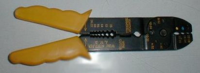

Just my $.02. A special crimping tool for the Deutsch connector is not really a necessity. I found a standard wiring/crimping/stripping tool to work just fine. Besides, I have two from days-gone-by in my chest already.
That is good to know...thanks. I assume you mean a high-end tool, and not the houshold wiring variety.
Just one of these...
View attachment 31924 :2thumbs:
From what I have seen of the Deutsch connectors and crimper, a crimper that fits the pin diameter closely, and crimps an indented or inverted pattern is standard. For reliability I would stick to the Deutsch crimper (or equivalent) or solder the pins. A plain crimp will likely fail in time.
