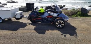

I went the same route kinda. I wanted more storage for a longer run. I like to run solo too. I made my storage out of Rigid tool boxes from Home Depot. I have a rack on the back of mine and a Smoothspyder backrest. I ran up the PCH last winter. Everything stayed dry and had plenty or room. Added bonus, you can expand storage by attaching other boxes. 20190130_131005_014.jpg
