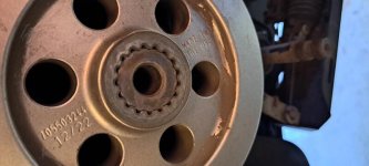

I looked at the pulley and belt. Had the recall done last season. There is no red dust on the pulley. I will look at it again; and check my Lamonster damper. I replace it every 20k or so. It's due for that.
Well the splines on the front pully look good. I'm going to put it back together and test ride. It may be a clutch problem but it shifts good.

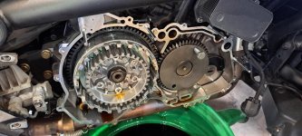

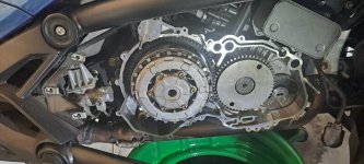

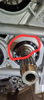

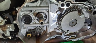

Update. Got the clutch cover and clutch basket out. The bearing plastic cage broke on the transmission shaft causing all the growling and vibration. Clutch looks ok Need to pull motor and remove transmission and split tranny case to replace bearings. Anyone seen a video removing the motor on an F3? I saw one on a '16 RT, but was a crappy video. Smoaks has one with the engine out, and the tranny removed and split. I have had all the plastic panels off the bike before.

It's good you found the gremlin, but it sucks that it was that far inside the motor!! Good Luck!!
You are one fearless rider! You're biting off quite a bit with this task. My hat is off to you sir! It would be lovely if you could document your progress with pictures. Not to add difficulty to your labor. Just a request.
I will take pictures of the process. I was a certified auto tech for my career, so I'm not afraid to tear into things. I also have a friend helping me that has strong mechanical background. He rebuilds classic cars. He has been into a lot of different types of gearboxes. I'm thinking the motor comes out the left side of the bike.
