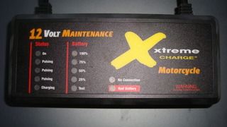

I wanted to ryde mine to work today. It turned over but gave me a VSS error message and wouldn't do anything else. I tried the relays and still nothing.:mad: :mad:
Charge the battery. If it is charged, I suspect it may need replacement.
:agree: You may have 25% charge:
Scotty, your a genius! The battery just needed a charge!
Is a battery tender designed to be left plugged in all the time or just before a planned ryde to "top it off"?
If it is a Battery Tender or one of the other sophisticated motorcycle chargers, it can be left on a maintenance free (sealed) battery. I leave mine on four bikes with sealed batteries all winter.
