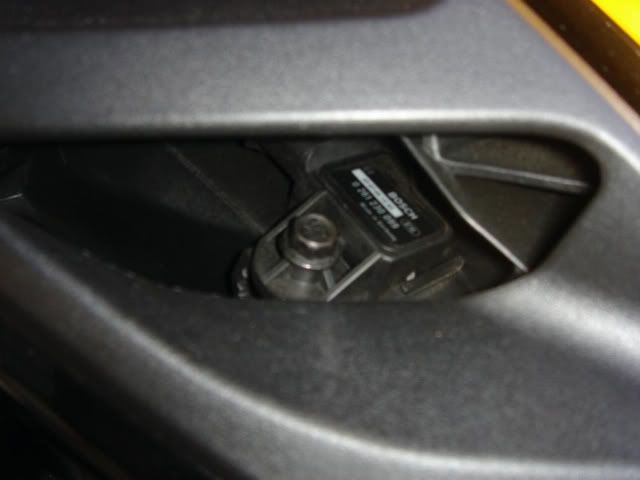

On the other Can Am board there was talk about the AAPTS and Tharkun#409 posted a picture of his and didn't know why his ambient temps were pretty close to being right and mine and some others were so far off. :dontknow: He was right, his was where it should have been and mine and Rons were still ziptied to the shock tower. That tells you how much some of these dealers pay attention to the PDI. :edit:
This is where it should be.
This is what Rons looks like.
And this is where I found it.
"Add the foam provided in ths PDI kit to protect the
tip ot the AAPTS.
Re-route the cable throught he 2 retalning guide
clips.
Connect AAPTS sensor harness to sensor on RH
front side panel.
Secure it using a bolt and plastic nut included in
the PDI kit."
